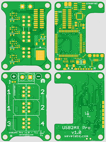

Ok, so that’s it, I pushed the files to github if you want to have a look : https://github.com/Xevel/usb2ax_pro
The PCBs look like this :
And there is a good chance that on your screen it looks much bigger than it really is (32x44mm).
The top PCB, on the right, has 6 3-pin TTL Dynamixel connectors, two pairs of which are connected together.
Each of the 4 Dxl lines has its own level shifter (the MCU runs at 3V3), and protection against ESD and over-current. Like on the USB2AX, shorting DATA to +12V will not harm the MCU or the computer. It is however a different protection that I designed around a JFET, and it should be comfortable protecting from up to +/- 25V while allowing 3Mbps communication the rest of the time. The protection used in the USB2AX had problems going too fast. We’ll see how it works out in the field.
It also has a big screw terminal (rated 16A) and a big MOSFET (DMP4015SK3-13) piloted by the MCU that controls power from the screw terminal. This power goes only to the servos, the MCU itself is powered from USB.
On the Main board are the MCU (an ATSAM3U1CA-AU, 96MHz, 64K FLASH with integrated USB2.0 High-Speed PHY, QFP-100) with its crystal, Micro USB connector, MPU-6050 IMU, 32KB of EEPROM, 3 leds and a button.
There are some gpios broken out on pads on the bottom but they are only intended for debugging (the 7 thin and wide pads on the bottom right of the pic) and might disapear in following versions to make the back of the PCB completely isolated. There is also a SWD + SWO port for programming/debugging.
There is also a voltage divider to measure voltage on the Dxl bus before the MOSFET (so you can monitor voltage before turning the servos on). You could also use that to see when power is lost and react accordingly (this way the robot would not jump when power returns).

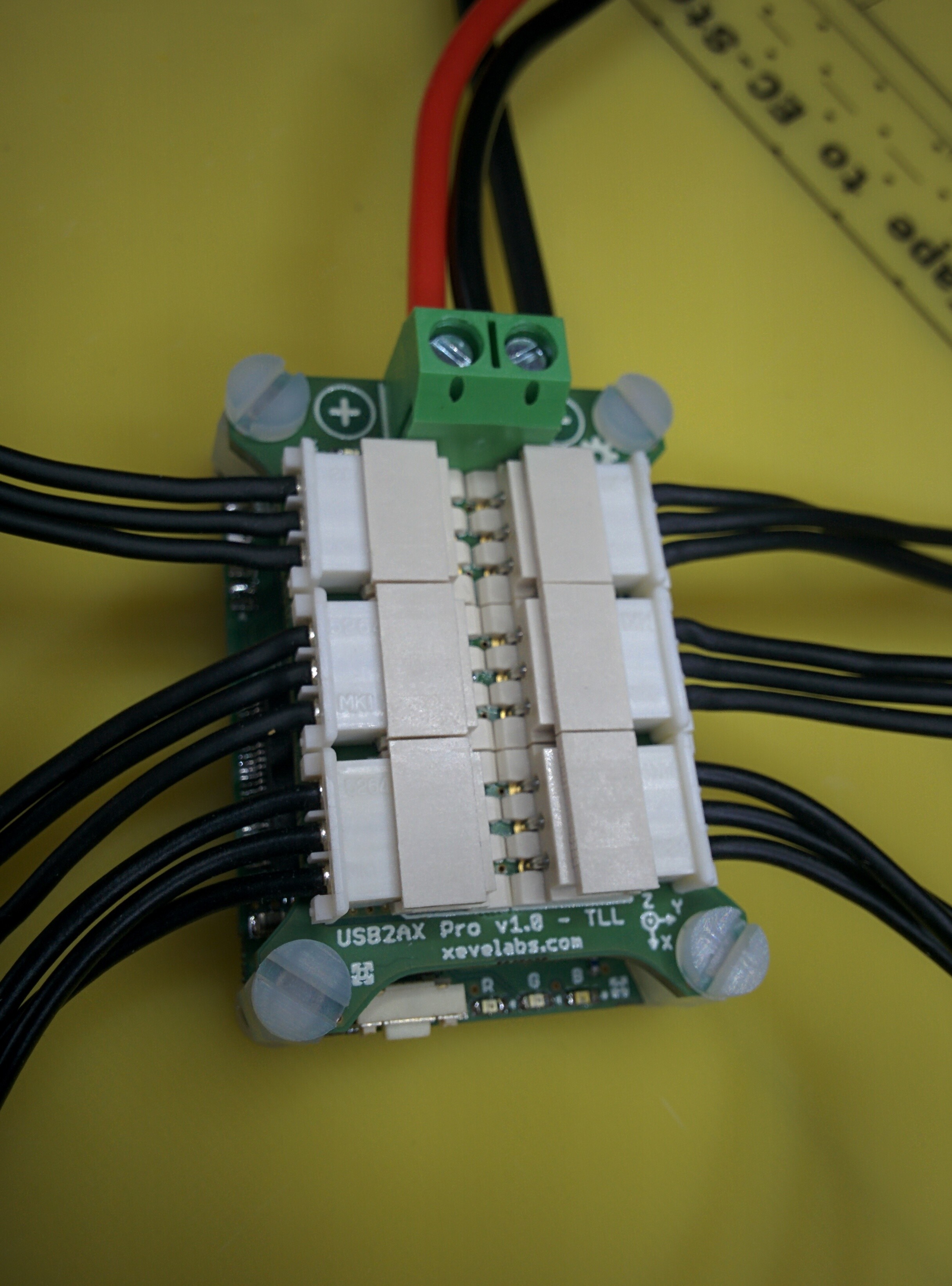

The PCB panel with, among other things, the USB2AX Pro, has arrived today, a few days in advance :slight_smile:
New photo by Nicolas Saugnier
Just have to wait for the MCU now, that I had to order at Arrow and Schukat instead of the usual distributor. That’s the thing after having used Farnell for so long, with their <24h free delivery, everything else seems so slow.
Good, if I resume the differences with the actual USB2AX :
_ The possibility to put different motors (AX, MX, XL , XM…)
_ The possibility to run a loop at high frequency on the MCU. So you can retrieve values from servo very close to real time.
_ A high speed USB, so you can ask any values store in the MCU with a low latency time. For example, if you need to have a present position with Pypot, you just need to read a MCU register wich is really faster than asking all the servo on the bus.
_ An IMU with possibility to put a firmware to calcul positions.
Tell me if I wrote something wrong :wink:

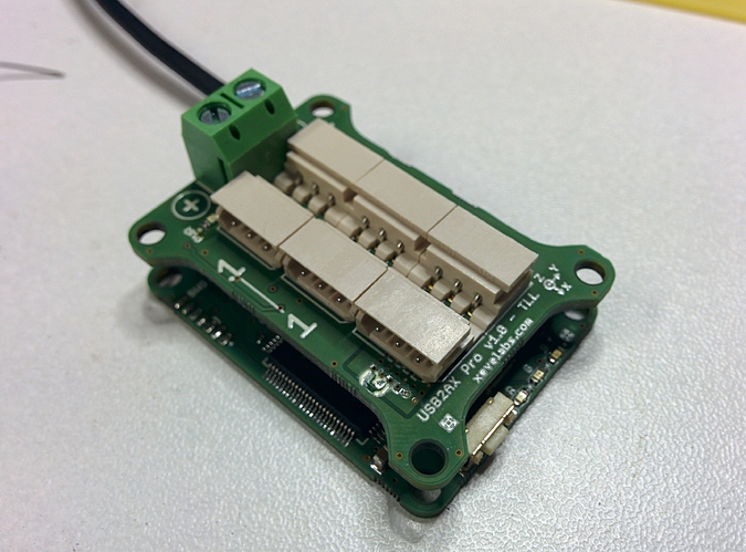

Assembled, but missing the mechanical components (standoffs, and a 3D printed strain relief):
And the album with more pictures of assembly and the rest of the projects on my panel : https://goo.gl/photos/49VdDNXw41NjZAnB9
Are you using a home made oven to solder the components ?
I got the cheapest small oven with convection (“chaleur tournante” en parlance marketing francais) that I could find on amazon at the time (50€ shipped), and just added a thermocouple on a multimeter to show the current temperature.
I’m quite OK with losing the 5 minutes it takes to manage that myself instead of having a PID. I only bake boards at most a 1-2 times a month, for prototyping. A PID is not worth investing in unless you do production.
And I can routinely do 0201 and sometimes BGAs with that setup.
