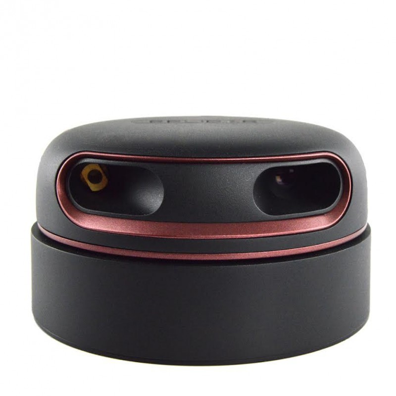

Because the usb2AXpro communicate in UART TTL and send data to usb. I wonder if it could be possible to adapt the firmware to manage an Rplidar A2. http://www.slamtec.com/en/lidar
LR001_SLAMTEC_rplidar_protocol_v0.1_en.pdf (1.8 MB)
Right now the 4 available USART/UART are dedicated to dynamixel lines (with circuitry on the top pcb to support it), so it would not be practical as-is.
However you could make a new top pcb to use one of the serial ports differently and modify the firmware, sure.
