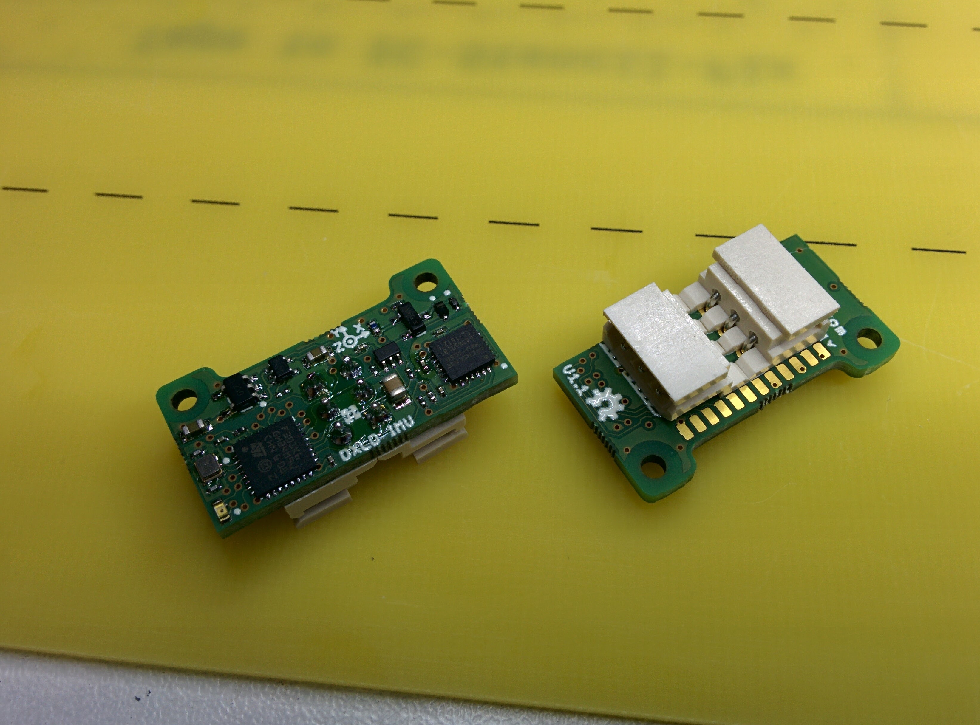

Here are my new attempts: an IMU board named DXLD IMU, and an interface board DXLD Interface.
dxld is the name of my dynamixel device lib that I released last year (and which nobody gave a **** about), and these will use the new version of that lib.

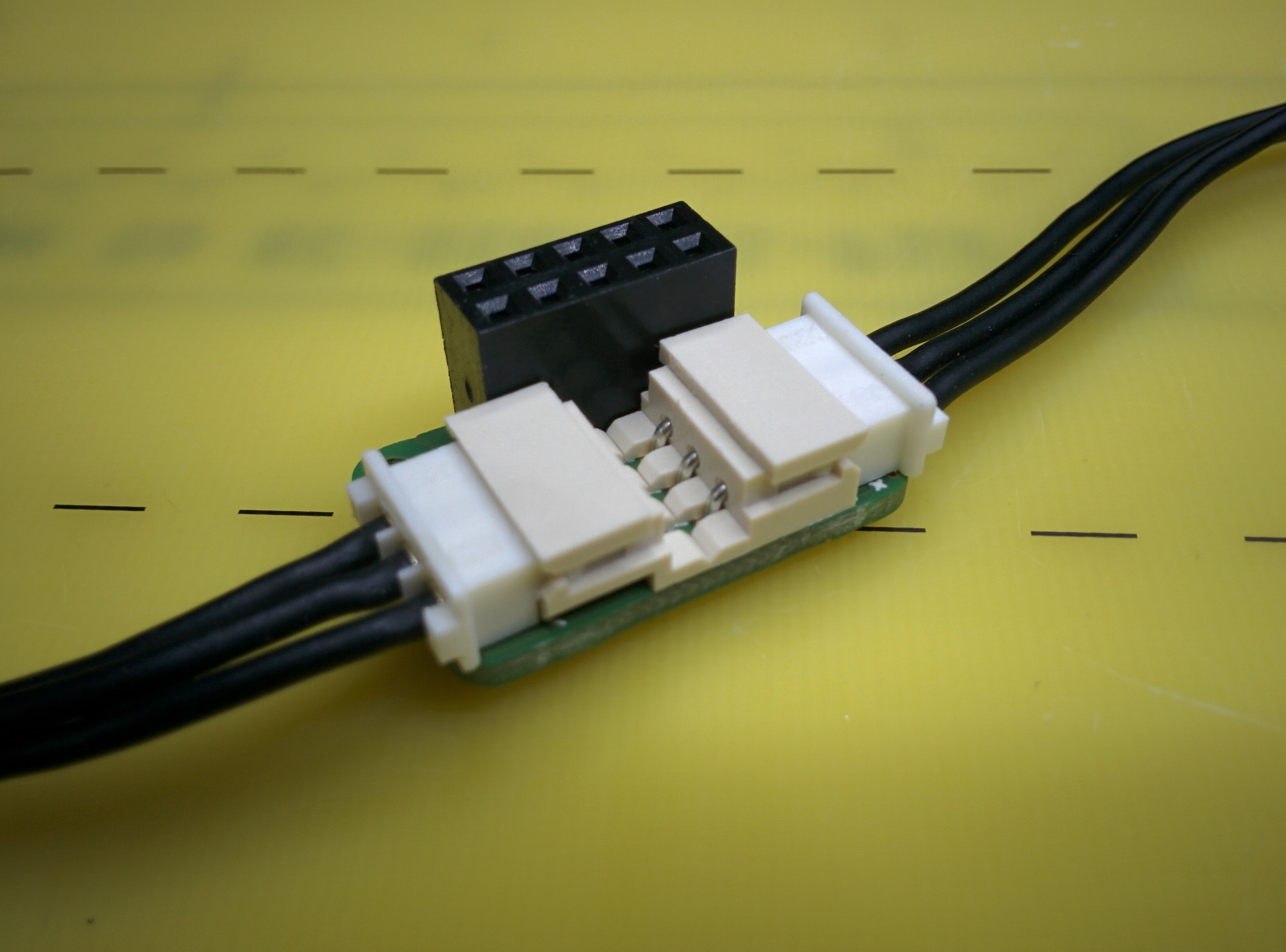

They are as small as technically possible while keeping 2 right angle Dxl connectors (for low profile) and M2 mounting holes. When the cables are connected the volume taken does not go up, meaning that the 26mm long PCB is the same length as two connected male+female connectors.
I could have gone with a side-by-side arrangement instead and landed a 22x21mm form factor for the IMU one, but not for the interface.

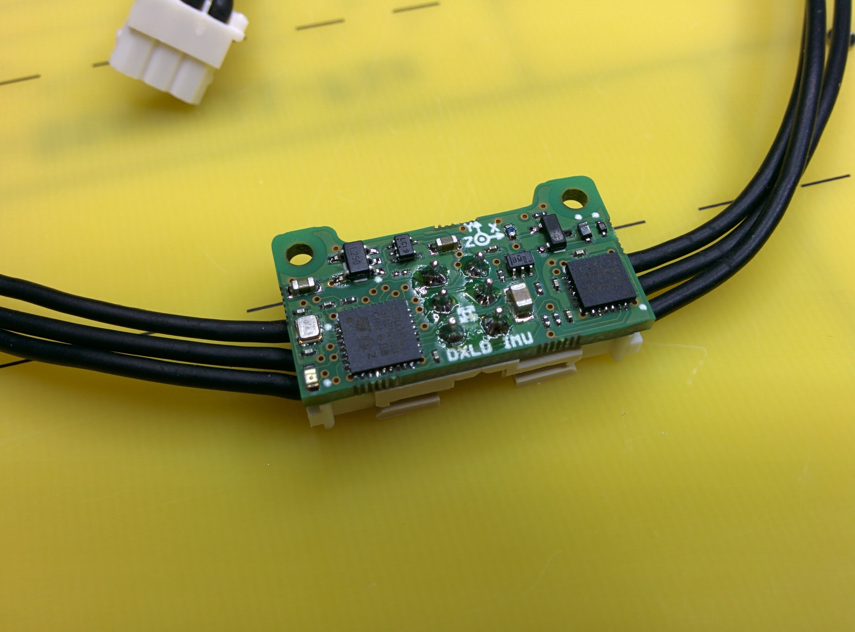

DXLD IMU is 26x14mm, with M2 holes 22mm apart.
It has a MPU-6050, and that’s about it. lots of 1.27mm debug pads on the bottom though.
I made it mostly for Thot, with the idea to test a lot of things on his robots.
DXLD Interface is 24x15mm with M2 holes 20mm apart.
It has a 2x5 2.54mm header that can be plugged into a breadboard, or used directly to connect stuff to.
The pins are 12V, 5V (500mA thanks to a DC/DC converter), 3.3V, GND and 6 GPIOs that also multiplex as PWM, 4 ADCs, I2C, SPI and a serial port (it’s possible to use SPI + serial or SPI + I2C or serial+ I2C).

Both boards share the same architecture, same MCU (STM32F301, Cortex-M4 @ 72MHz with FPU, 3.3V) and same Dynamixel level converter and protection. It can talk on the bus at up to 3Mbps (maybe more, I’ll have to verify).

Here is what they look like when assembled :
Lot more pictures, including the other projects I stuffed on the same PCB panel : https://goo.gl/photos/49VdDNXw41NjZAnB9
There are already some details I’m not a fan of before even powering them:
  • big 10pins connector on DXLD Interface is too high for something with M2 fixation holes
  • capacitor choice on power rails is not the best. At first I put ceramic ones, but between all the de-rating (voltage bias reduces their effective capacity by about 70 to 80% in this case) and the high price, I will need another solution. I temporarily put some tantalum in the meantime.
Next step, bringup (= powering up and writing the basic firmware to test everything)!
