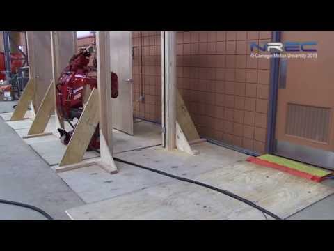

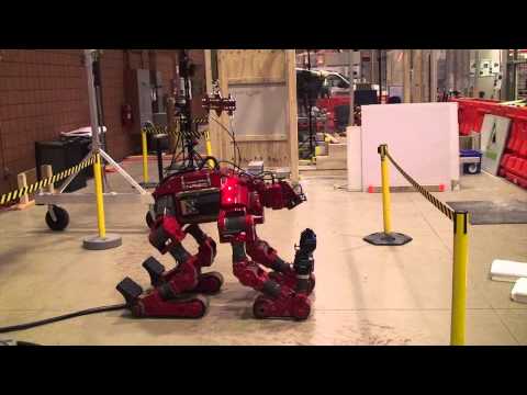

Your idea is so good it has already been explored with one of the robot doing the Darpa Challenge, it is CHIMP made by the (also) very famous CMU:
http://spectrum.ieee.org/automaton/robotics/humanoids/cmu-chimp-humanoid-robot-moves-like-a-tank

Yeah Xevel I saw the transformer it’s very cool! The most similar one to what I am thinking is the CHIMP one, but I think it can only move on wheels, even when it’s standing it doesn’t seem to be able to have bipedal walking? Maybe this is a new addition?
