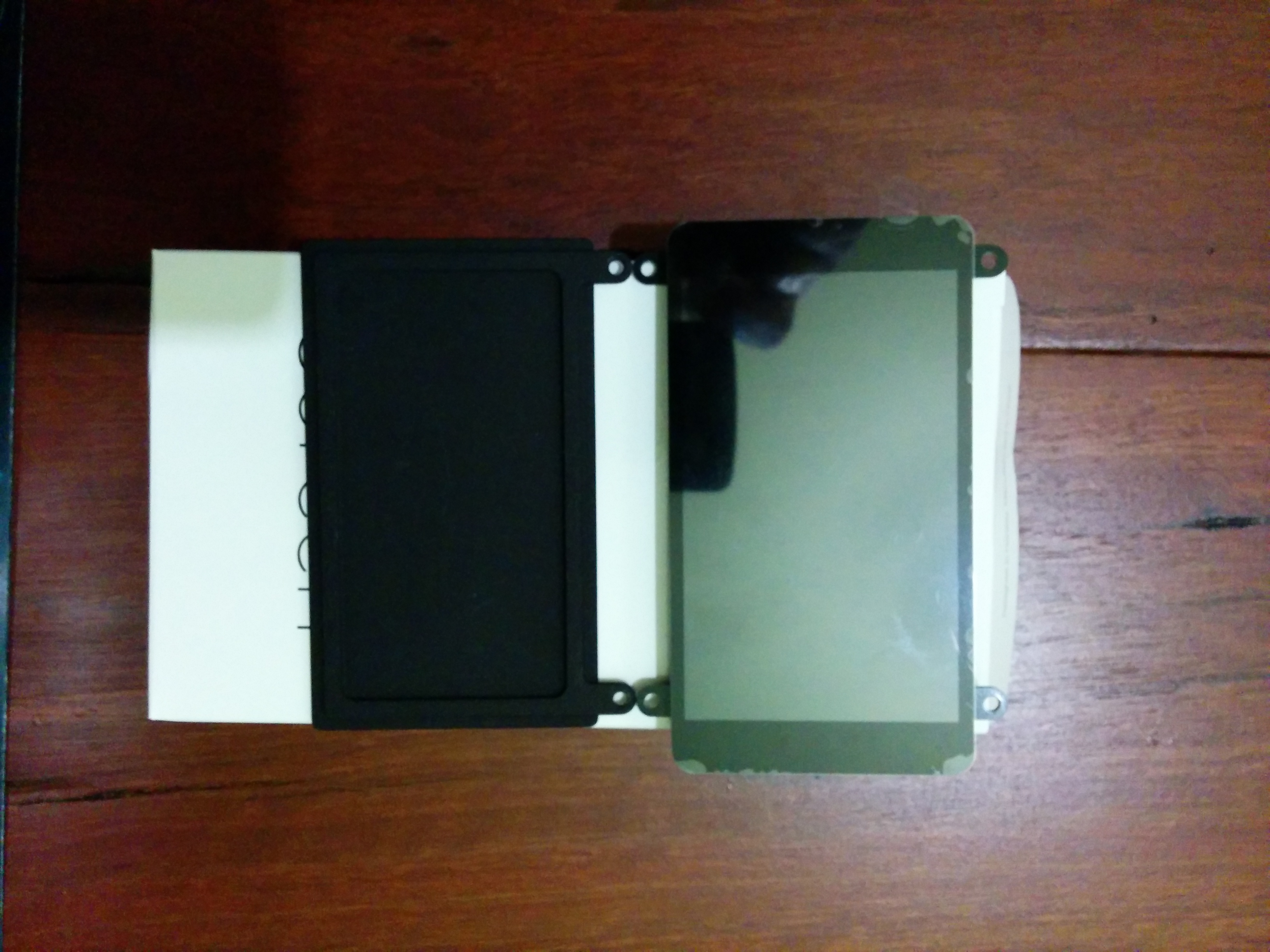

Hi!
I got a few productin manga screens but they seem to have changes dimensions slightly and don’t fit in the head of Poppy Humanoid.You can see the screen is larger than the blank plastic piece that fits in the head.
Cheers
Hi!
Cheers
Can you remove the touch screen ?
Hello @john, we just received the new manga screen and I confirm, you can remove the touch screen.
It is quite easy as there is only soft glue around the screen.
You just have to slowly sweep a thin plastic part between the screen and the touch screen.
