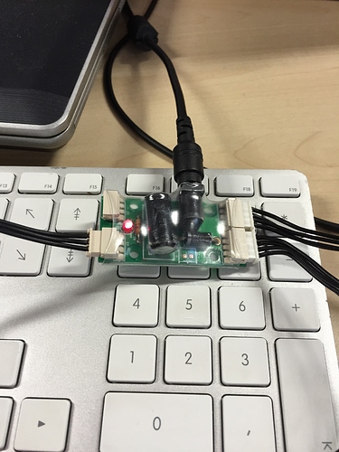

The RS thing I was referring to is this device:
So if you are having an answer from the scan even without no motors when using TTL there is definitely something wrong with the wiring or one of the eletronical device. Can you try to replace them all (wire, usb2dynamixel…)?
